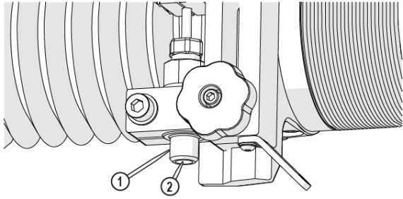

Inspect the pump between the crankcase [1] and the adapter block [2] for evidence of leaks. See the Maintenance Schedule for the recommended frequency for this task. If a leak is found, contact technical support.
Figure 471

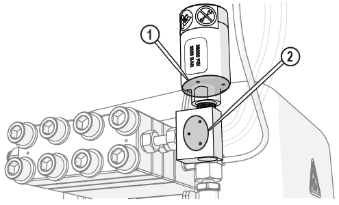

Correct Safety Valve Water Leaks
The following identifies the source of possible water leaks in the safety valve and how to correct them.
Figure 472
Leak Leak Description Suspected Cause Recommended Action
[1] Leak from safety valve body weep holes Seat to ceramic ball failure Replace the Safety Valve
[2] Leak from T-fitting weep holes Seat failure Replace the Safety Valve
CAUTION
Never attempt to adjust the safety valve; doing so creates a safety hazard and voids the warranty!
The safety valve functions to prevent excessive build-up of water pressure in the high-pressure plumbing system. During normal operation, the pump can reach extremely high pressures. When excessive-high pressures are detected, the variable frequency drive (VFD) slowly lowers the motor’s revolutions per minute (RPM) to prevent over-pressuring the system. If lowering the RPM does not prevent an overpressure condition, the safety valve activates when the factory preset pressure is reached (approximately 38 ksi), releasing the excess pressure.
Replacing the safety valve is required when leaking occurs during normal cutting operations.
CAUTION
If leaking continues to occur or if the calibration seal [1] has been broken, tampered with, or damaged, replacement of the safety valve assembly is required.
Figure 473
1. Turn OFF the machine.
Figure 474
2. Remove the front and right side panels.
3. Disconnect the pump power cable.
Figure 475
4. Ensure there is no pressurized water in the high-pressure lines.
a. Open the lid and lock it in the upright position.
CAUTION
Use care when opening or closing the lid to avoid injury. Never let the lid free-fall. Keep hand, fingers, or body parts away from the side of the table when closing the lid.
b. Loosen the gland nut [1] to release the pressure; water can leak from the inlet body weep hole.
Figure 476
c. Tighten the gland nut [1].
Figure 477
5. Disconnect the transducer cable [1].
NOTICE
Protect the connecting ends from external contamination or debris. Debris can enter into the high-pressure plumbing system and damage the pump or nozzle.
Figure 478
6. Loosen the T-fitting gland nut.
Figure 479
7. Rotate the safety valve assembly counterclockwise until it contacts the water hose and can rotate no more.
NOTICE
Safety valve internal components are loose and can fall out if the safety valve is removed while positioned vertically. Rotating the safety valve assembly to a more horizontal position before removal makes it more difficult for internal components to fall out on their own.
8. Remove the safety valve [1].
Figure 480
9. Carefully remove the protective cap from the new safety valve.
NOTICE
The protective cap keeps debris from contaminating the safety valve interior and keeps the internal components [1] from falling out. Always hold the safety valve with the stem up when removing the protective cap to keep the internal components from falling out and becoming contaminated with debris.
Figure 481
NOTICE
Avoid areas where Blue Goop can enter into the high-pressure water system (the tip of the safety valve body and the tip of the seat). Do not apply excessive amounts of Blue Goop onto the threads or seat of the safety valve. Excess Blue Goop can enter into the high-pressure water system and cause damage.
10. Apply a very light coat of Blue Goop onto the coned end of the seat [1] and the threads [2] of the safety valve, if not already applied.
Figure 482
11. Install the safety valve [1] onto the T-fitting [2] then hand-tighten.
Figure 483
NOTE
The jaws of the crowfoot must maintain a 90-degree angle to the horizontal axis of the torque-wrench handle throughout the torquing rotation. Other angles of orientation can alter the set torque.
Figure 484
12. Torque the safety valve [1].
Figure 485
13. Rotate the safety valve so that it is perpendicular to the floor.
14. Torque the T-fitting gland nut.
Figure 486
15. Apply a heavy coat of dielectric compound to the transducer cable [2], then connect the transducer cable to the transducer [1].
Figure 487
16. Apply a heavy coat of dielectric compound to the power cord plug [2] (Figure 488).
17. Aline the notches [1] on the power cord plug and power connector [3], then push until the power cord plug seats in the power connector(Figure 488).
18. Rotate the shell counterclockwise until the threads engage, then turn the shell clockwise to tighten.
Figure 488
19. Flush the high-pressure plumbing, see Flush the High-Pressure Plumbing.
20. Reset the pump, see Reset the Pump.
21. Install the nozzle, if removed, see Install the Nozzle, perform a nozzle test, and see Test the Nozzle.
22. With the pump running at high pressure, carefully inspect the safety valve for signs of water leakage. Correct all leakage problems before continuing.
23. Replace the side panels, see Install the Side Panels.

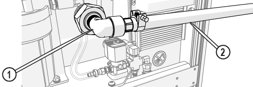

Place and Connect the Pump
1. Roll the pump under the table, leaving a 1–2 in. space [2] between the back of the pump and the control cabinet, then lock one of the pump wheels [1].
Figure 489
2. Connect the cooling line OUT to the push-to-connect OUT connection [1] on the pump. The cooling OUT line and connections have yellow cable ties attached.
Figure 490
3. Connect the cooling line from the IN connection [2] on the pump to the push-to-connect fitting [1]. The cooling IN line and connections have red cable ties attached.
Figure 491

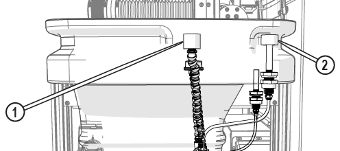

Do not use teflon tape or pipe sealant on the water connections. Teflon thread or sealant particles can enter into the high-pressure plumbing system and damage the pump and nozzle.

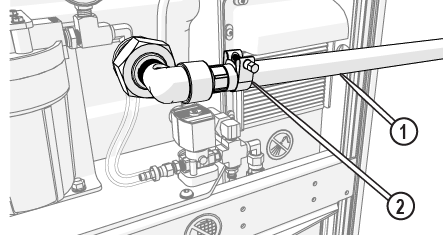

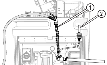

4. Connect the supply water hose from the pump wet end [2] to the 90-degree fitting [1] and tighten.
Figure 492

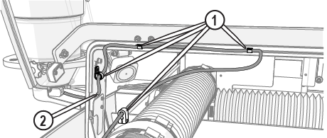

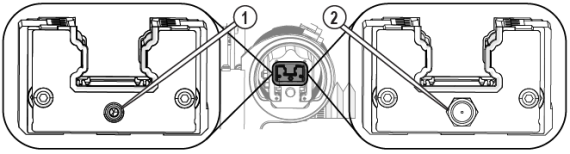

Figure 493
Figure 494

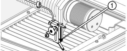

2. Verify the collar [1] is installed in the correct position using the stand-off tool [2], then adjust the collar to the correct depth if needed.
Figure 495

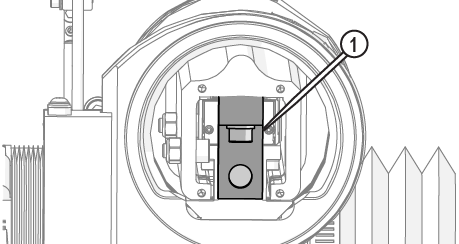

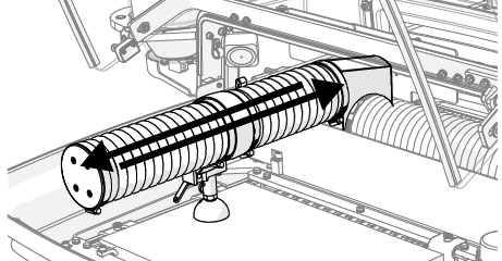

3. Position the pump so that the high-pressure plumbing is aligned vertically and horizontally, and the rear of the pump is 1–2 in. from the control cabinet.
Figure 496

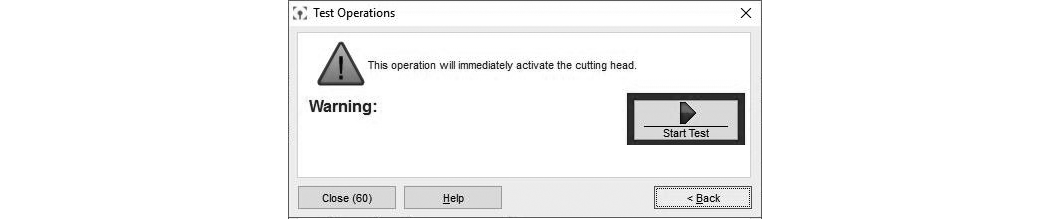

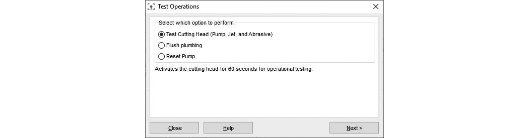

Reset the Pump
The reset pump test runs a 30-second sequence to reset the pump. Do this test:
  • Before operating the ProtoMAX for the first time
  • After changing the nozzle orifice
  • Repairing or replacing the pump
  • Repairing high-pressure plumbing leaks
  • When required by a fault or alert message

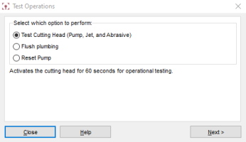

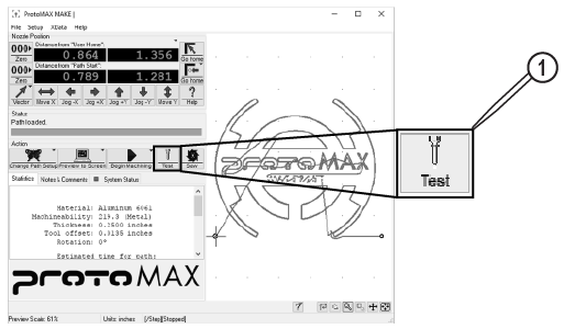

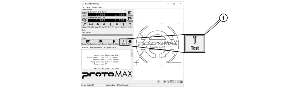

1. Open MAKE.
2. Move the nozzle between two slats.
3. Click Test.
4. In Test Operations, select Reset Pump, and click Next.
5. Click Start Test and check the high-pressure plumbing for leaks (the dialog box closes when the test is complete).

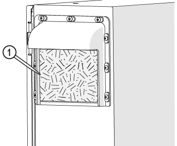

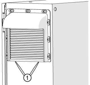

Change the Electrical Control Enclosure Air Filters
The air filters make sure debris and other pollutants do not enter the electrical enclosure. Regular air filter changes reduce wear and damage to enclosure control electronics. See the Maintenance Schedule for the recommended frequency for this task.
1. Press up on the tabs located under the bottom edge [1] of the filter cover and lift the cover using both hands to unhinge it from the frame.
Figure 505
2. Tilt and lift the filter cover out from the electrical control enclosure.
3. Remove and discard the old filter [1].
Figure 506
4. Wipe any debris from the filter cover surfaces.
5. Press the new filter into the receptacle.
6. Reinstall the filter cover.
7. Repeat the steps to change the filter on the other side of the machine.

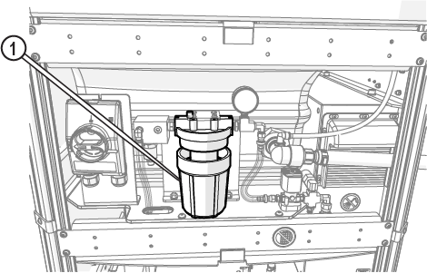

Change the Water Filter Cartridge and Inspect O-ring
The water filter removes debris from the incoming water. See the Maintenance Schedule for the recommended frequency for this task.
Figure 507

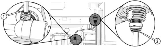

CAUTION
Figure 508

5. Remove the water filter housing [1].
Figure 510
6. Remove and discard the filter element.
7. Wash and rinse the filter housing to remove all sediment and coatings from inside the filter housing.
8. Inspect the filter housing O-ring [1] for damage and replace it if needed (Figure 511).
9. Apply a light coat of silicone to the filter housing O-ring [1], then insert it into the water filter housing.

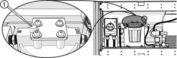

13. Place a rag over the top of the filter, then hold down the air bleed button [1] to release air from the filter.
NOTE
If all of the air is not purged from the filter, the pump cannot develop sufficient pressure, and the pump shuts down.
Figure 513

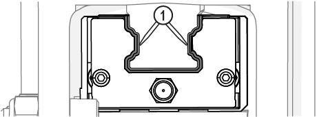

Rotate or Replace the Slats
CAUTION
Bacteria in the tank water can build up. A minor break in the skin can introduce harmful bacteria into a wound. Always wear protective gloves if you have cuts or open wounds on your hands. Wear gloves that protect against sharp metal edges.
In time, table slats can become scored with deep garnet abrasive waterjet cuts and become unable to provide stability and support required for precision cutting. See the Maintenance Schedule for the recommended frequency for this task.
NOTE
The working life of a slat can be significantly improved by periodically rotating them to different table locations.
When replacing a defective slat, inspect the slat comb for excessive wear and replaced them as needed. Worn slat combs allow the slats to rock back and forth, which can interfere with cutting precision.

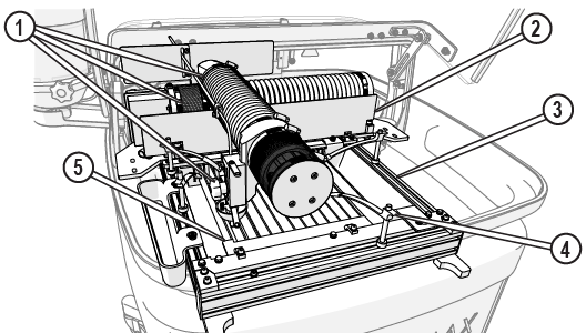

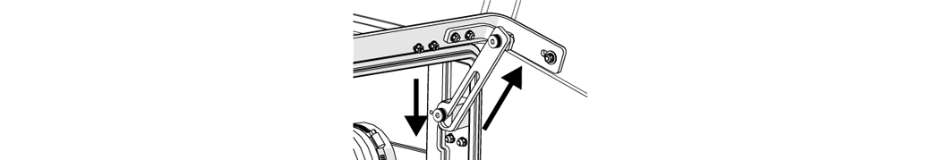

1. Open the lid and lock it in the upright position.
CAUTION

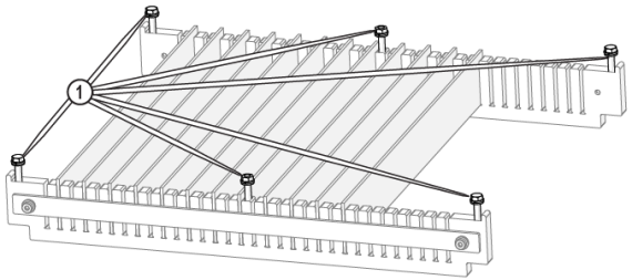

3. Loosen the cutting deck bolts [1] and align the t-nuts [2] with the frame slot [3].
Figure 515
4. Move the Y-axis to allow enough space to remove the cutting deck.
NOTICE
Use care when removing the cutting deck to avoid damage to the Y- and Z-axes and the nozzle assembly.
5. Carefully lift the cutting deck out of the catcher tank.
Figure 516

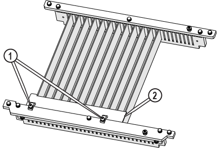

If a mark is not placed on the mounting plate, a new fixturing plate needs to be cut after re-installation.
Figure 517
7. Loosen the fixturing plate screws [1] and remove the fixturing square [2].
Figure 518
8. Remove the screws [1] and the mounting plates [2].
Figure 519
9. Reinstall the screws [1] in the slat combs and hand-tighten to prevent dirt or debris from entering the screw threads.
Figure 520
10. Remove all badly worn slats.

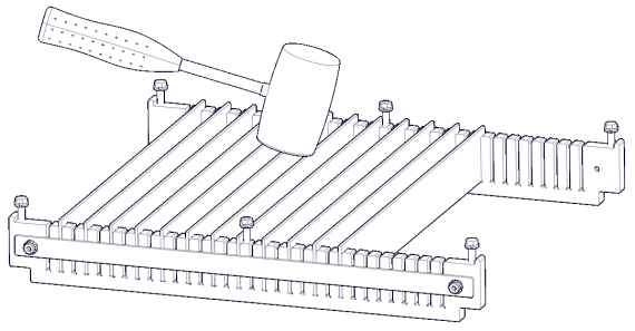

11. Tap the slat combs and slats with a soft blow mallet to dislodge encrusted garnet, if needed.
Figure 521
12. Clean the slat combs and spray the slat assembly with a strong stream of water.
13. Rotate or replace slats as needed.

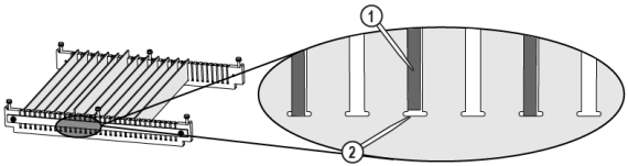

NOTE
Ensure the slat(s) [1] are seated flat against the slat comb slot [2]. Slightly raised slats can cause materials to wobble while cutting.
Figure 522

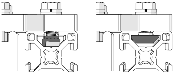

Use care when installing the cutting deck to avoid damage to the Y- and Z-axes and the nozzle assembly.

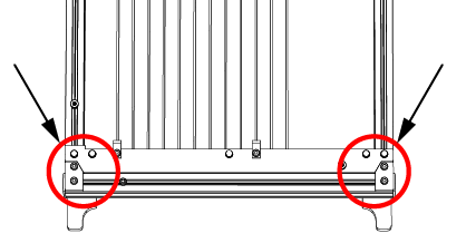

a. Rotate the t-nuts to align with the frame slot and tighten the t-nut bolt.
b. Place the cutting deck on the frame with t-nuts [1] in the frame slot [2].
Figure 525
c. Make sure that the notches in the cutting deck align with the front mounting plate brackets.
Figure 526
d. Loosen the t-nuts completely, then tighten to lock in place.

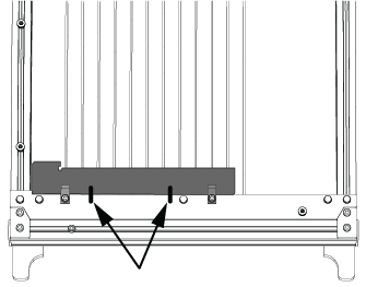

Figure 527
Figure 528
19. Align the fixturing plate to the marks and tighten the screws [1] or recut the fixturing square [2]. See the Software Help files about fixturing squares.

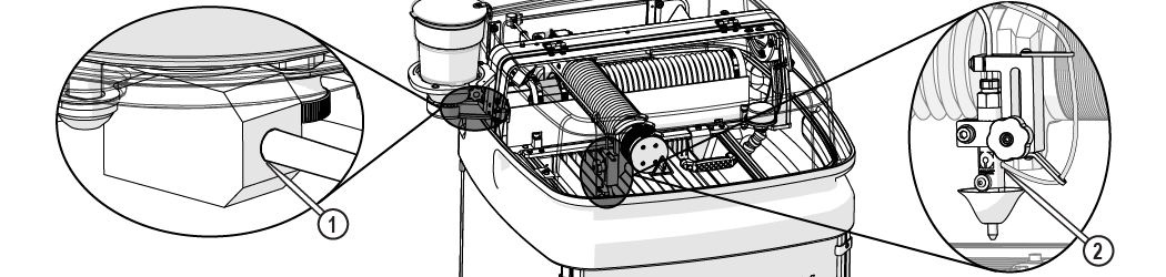

Before performing maintenance on the high-pressure lines, release all pressurized water.
1. Turn OFF the macine [1], if needed.
Figure 531
2. Clean all high-pressure lines and components thoroughly before disassembly to remove all abrasive and debris.
3. Turn OFF the water, if needed.
4. Turn OFF the breaker power switch, if needed.
5. Make sure there is no pressurized water in the high-pressure lines.
CAUTION
b. Loosen the Z-axis tubing clamp [1].
Figure 532
c. Loosen the gland nut [1] to release the pressure; water can leak from the inlet body weep hole.
Figure 533
d. Tighten the gland nut [1], if needed.
Figure 534

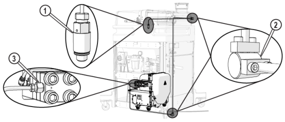

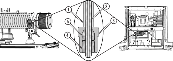

High-Pressure Gland Nut Assembly
Gland nut connections are located at the high-pressure nozzle and the pump. The high-pressure gland nuts consist of the following components.
Figure 535
[1] Conduit [2] High-pressure nipple [3] Gland nut [4] Collar [5] Slotted collet

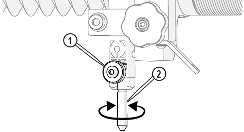

2. Raise the Z-axis approximately 1 in. (3 cm).
3. Completely loosen the gland nut [1] from the inlet body.
Figure 536

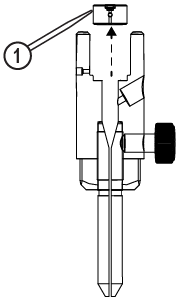

11. Use the stand-off tool [1] to set the collar depth.
NOTICE
High-pressure nipples have left-hand threads, therefore when connecting components, turn clockwise to loosen and counterclockwise tighten. Cross threading high-pressure connections can cause leaks and water damage from the leak(s).
Figure 541

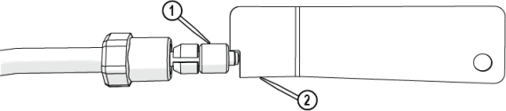

Figure 551
11. Attach the assembled u-shape nipple [1] to the pump high-pressure outlet OUT connection [2] and hand-tighten.
Figure 552
12. Verify the gland nut [2] is set approximately to the depth of the nozzle stand-off tool [1].
Figure 553
13. Adjust the position of the bracket [1], then tighten the bracket.

Maintain the High-Pressure Fittings
NOTICE
Nipples contain small caps to protect the threading and keep debris from entering the high-pressure plumbing during shipment. Remove the caps before assembling the high-pressure plumbing fittings. Do not use pliers to remove the black caps or cut the black caps from the nipple. Pliers and knives can damage the nipple threads causing leaks and water damage.
NOTE
When preparing the ProtoMAX high-pressure tubing, it is important to follow instructions. Some high-pressure tubing and fittings are pre-assembled. Fittings may need readjustment during installation to make sure proper seals and eliminate potential leaks. Use the provided stand-off tool to make sure the fittings are correctly seated and sealed.
High-pressure fitting connections are located on the ends of the high-pressure nipple at the back of the machine. The high-pressure fittings consist of the following components.
Figure 559
[1] Conduit [2] High-pressure nipple [3] Bar clamp [4] Bar clamp screw (x 2 per bar clamp) [5] 90-degree fitting

a. Place the high-pressure line [2] in the conduit [1] (Figure 561).
b. Place the bar clamp [3] over the high-pressure line.
Figure 561
5. Seat the high-pressure nipple [1] into the high-pressure fitting [2] and secure with the bar clamp and screws.
Figure 562
6. Tighten the bar clamp screws [1] evenly.
NOTICE
Always tighten the bar clamp screws evenly (1/4–1/2 turn at a time) to the correct torque to make sure the high-pressure nipple seats correctly. Do not overtighten the bar clamp screws. Over tightening the screws can damage the high-pressure nipple tapered edge or the concave high-pressure fitting and damage the high-pressure seal. Damaged high-pressure seals can cause the connection to leak.
Figure 563
NOTE
There is a small, even space [1] between the bar clamp and the high-pressure fitting when correctly torqued.
Figure 564

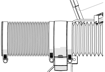

4. Rinse and wipe away all debris from the bellows [1].
Figure 565

Clamps can stick to the bellows. To prevent damage to the bellows, use care when removing the clamps.
Figure 567

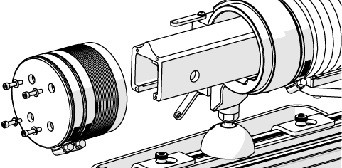

9. Remove the end capscrews [1] and set aside.
Figure 569
NOTICE
Use care when removing the bellows from the Y-axis carriage. Ripping or tearing of the bellows ends can allow debris in the Y-axis and can cause damage to the internal components.
10. Remove the end cap and bellows.

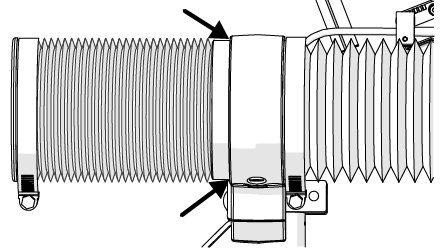

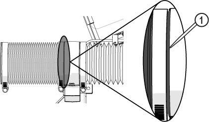

18. Reattach the rear bellows to the Y-axis carriage, pulling the bellows lip over the Y-axis carriage edge.
NOTICE
Ensure there is an even gap [1] between the Y-axis carriage housing and the bellows lip to keep debris from entering into the bellows and causing damage to the interior components.
Figure 574
19. Secure the bellows with the clamp [1].
NOTE
Make sure the bellows cuff does not move away or come off while tightening the clamp.
Figure 575

22. Identify if the lead screw support bracket configuration, then complete the applicable procedure.
• If there is access [1] to the grease port, go to Lubricate the Y-Axis Linear Rail Bearing Carriage with Grease Port Access.
Figure 577
• If there is no access [1] to the grease port, go to Lubricate the Y-Axis Linear Rail Bearing Carriage without Grease Port Access.
Figure 578

1. Remove the lead screw support bracket [1].
Figure 582
2. Identify if the linear rail bearing carriage has a set screw [1] or grease fitting [2].
If there is a grease fitting, complete Step 3. If there is a set screw, complete Step 4.

3. Pull the front bellows to the Y-axis carriage, pulling the bellows lip over the y-axis carriage, ensuring there is an even gap all around the y-axis carriage.
Figure 590
4. Attach the clamp, confirm the gap around the Y-axis carriage then tighten the clamp.
Figure 591
5. Verify the bellows cuff [1] has not pulled away from the carriage housing.

11. Move the bellows to the ends of the axis and clean all debris from around the lead screw nut [1] with a dry, soft cloth.
Figure 600
12. Apply a light coat of lubricant, approximately 1/8 in. bead, along the length of the lead screw [1], then spread the lubricant along the lead screw surface.

17. Reattach the bellows to the X-axis carriage, pulling the bellows lip [1] over the carriage edge [2].
NOTE
Rotating the bellows helps to eliminate rub marks or holes on the interior of the bellows, prolongs the bellows life. If needed, loosen the clamp at both ends of the bellows, rotate the bellows approximately 90 degrees then secure with the clamps.
Figure 605
NOTICE
Make sure there is an even gap [1] between the X-axis carriage housing and the bellows lip to keep debris from entering into the bellows and causing damage to the interior components.

2. Gently spray the X, Y, and Z-axes bellows [1] and components, the backplate [2], the cutting stage frame [3], material holding fixtures [4], and the slat or polymer cutting deck [5] to rinse the sludge into the catcher tank and garnet bins.
NOTE
To prevent water or sludge from splashing out of the machine, do not use a forceful spray of water.
Figure 612

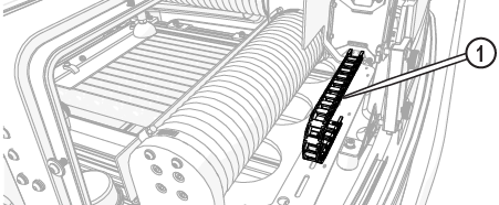

Clean the Cable Track
NOTICE
To avoid damage, do not use flammable liquids or other chemicals to clean the equipment.
A cable track runs along the back of the machine behind the X-axis. The cable track protects the cables from crimping, binding, or other damage as they move along the X-axis of the machine. See the Maintenance Schedule for the recommended frequency for this task.
CAUTION

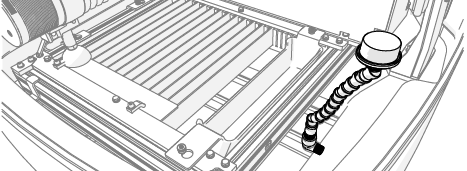

2. Gently spray with water to remove all particles from the cable track [1] and the surrounding area.
Figure 613
3. Inspect the cable track for damage and if damaged, contact technical support.
4. Close the lid.

The catcher tank has an adjustable drain and filter [1] and an overflow drain and filter [2] for maintaining the water level during operation. Each drain is equipped with a filter to keep garnet and other cutting debris in the catcher tank allowing the debris to accumulate in the garnet bins. See the Maintenance Schedule for the recommended frequency for this task.
Figure 614
NOTE

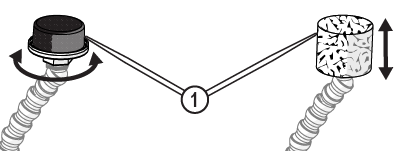

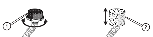

The machine is shipped with either metal screen filter [1] or a foam filter [2] installed. The metal screen filter screws onto the drainpipe, and the foam filter has a slot on the bottom for attaching to the drain pipe.
Figure 615
NOTICE
Water can damage the electrical control cabinet and other components. Always make sure the water in the catcher tank is removed, or the water is below the adjustable tank drain [1] and the tank overflow drain [2] before cleaning or removing the drain hoses and connections.
Figure 616
CAUTION
2. Remove the filters from the adjustable drain pipe and overflow drain.
3. Spray a strong stream of water through the adjustable pipe [1] and overflow tube [2] to wash away settled debris.
If spraying the drain pipe and tube does not dislodge debris or the water flow remains restricted, the drain pipe and tubes may need to be removed and cleaned with a brush, see Remove Tank Drain Clog.
Figure 617
4. Spray the filters with a strong stream of water to remove debris or replace if needed.
5. Reinstall the filters.
6. Close the lid.

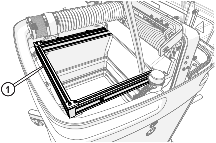

Figure 619
6. Remove the slat or polymer cutting deck for easy access.
a. Loosen the cutting deck bolts [1] and align the t-nuts [2] with the frame slot [3].
Figure 620
b. Carefully lift the cutting deck out of the catcher tank.
Figure 621

Remove A Tank Drain Clog
The tank drain hose connects to the elbow that exits the catcher tank at the bottom right rear and runs to the drain. The tank overflow drain is a secondary tank drain that prevents water from overflowing out of the catcher tank if the primary drain, filter, or the flexible line becomes clogged. The secondary drain hose is attached and exits from behind the bottom of the catcher tank area. If rinsing the tank drains do not clear the blockage, then complete the following:
1. Remove the water from the catcher tank.
CAUTION
Sharp objects can damage the catcher tank. Use care when removing tank sediment to avoid damaging the catcher tank walls.
2. Remove the sediment from the catcher tank.

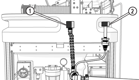

Remove a Flexible Tank Drain and Connection Clog
NOTICE
Figure 626
The tank drain pipe is attached to the drain filter and runs down to a drain elbow located in the bottom right, rear corner of the catcher tank. Silt and suspended particles from the cutting process can accumulate in this drain pipe and elbow over time, reducing the ability of the catcher tank water to drain from the tank. If the water flow from the catcher tank is compromised, clean the components of the drain.
Figure 627
CAUTION
2. Remove the filter [1].
Figure 628
3. Unscrew the drain pipe from the elbow [1].
Figure 629
4. Spray a strong stream of water through the drain pipe and elbow to rinse any debris or sludge from inside the components.
5. Scrub inside the flexible pipe and elbow to dislodge any remaining debris or sludge.
6. Clean the outside of the flexible pipe and rinse.
7. Replace the flexible pipe when joints are damaged or loose.
NOTICE
Do not overtighten the flexible pipe connection. Over tightening can cause cracking and breaking of the flexible pipe or elbow connection and can cause leaks.
8. Reattach the flexible pipe [1] to the elbow and tighten.
Figure 630
9. Reinstall the drain filter [1].
Figure 631
10. Close the lid.

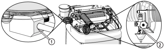

Remove an Overflow Drain Hose and Connection Clog
NOTICE
Figure 632
CAUTION
2. Remove the overflow drain hose from the -push-to-connect fittings at the drain elbow [1] and overflow port [2].
Figure 633
3. Spray out the drain hose using a strong stream of water.
NOTICE
4. Inspect and remove all debris from the drain ports.
5. Inspect the hose ends for damage. If damaged, replace the hose.
NOTICE
Do not cut the hose; it is precut for optimal performance. Cutting the hose can cause leaking after filling the tank.
6. Reinstall the overflow drain hose to the push-to-connect fittings at the overflow port [2] and drain elbow [1] (Figure 633).
7. Close the lid.

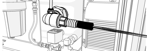

1. Cover the solenoid and pressure switch with plastic.
2. Remove the drain hose [1] from the drain elbow [2].
Figure 635
NOTICE
4. Clean out built-up debris in the drain connection.
Figure 636
5. Reinstall the drain hose [1] and secure it with the hose clamp [2].

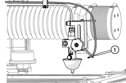

Nozzle Maintenance
This section contains procedures for performing the recommended nozzle maintenance. The nozzle body lasts approximately 100 cutting hours when correctly installed, operated, and maintained. Depending on water quality, the replaceable orifice assembly last approximately 30 cutting hours, the replaceable mixing tube and nozzle filter last approximately 50 cutting hours. The life of the nozzle splash guard is dependent on the type of material being cut and the number of pierces made. See the Maintenance Schedule for the recommended frequency for this task.
Always wear safety glasses when performing maintenance on the machine.
Replace the Abrasive Tubing
The abrasive feed tube is a consumable item and wears as the abrasive flows from the garnet abrasive hopper to the nozzle body. Cracks, chips, holes, or other damage at the nozzle entrance, hopper exit, and bends along the tube can compromise the abrasive flow to the nozzle. See the Maintenance Schedule for the recommended frequency for this task.
CAUTION

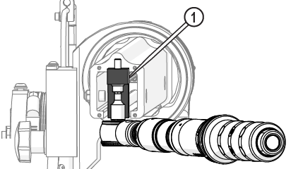

2. Remove the abrasive tube from the abrasive feed block [1] and the nozzle [2].
Figure 639
3. Remove the old abrasive tube from the tube clamps [1] and the roll bar [2] and discard.
NOTE
Do not cut the abrasive feed tube. The abrasive tube is cut the length required for optimal abrasive delivery. Only use OMAX feed tube kits.
Figure 640
4. Route the new abrasive tube from the abrasive hopper through the roll bar [2] and tube clamps [1], ensuring the abrasive tube is routed behind the cutting deck light, to the nozzle(Figure 640).
NOTE
Make sure there are no kinks in the abrasive feed tube or excessive bends along the route. Make sure there is enough slack in the abrasive tube between the connections so that the tube does not disconnect during operation.
5. Insert the abrasive tube into the abrasive feed block [1] and the nozzle [2] (Figure 639).
6. Close the lid.
7. Perform a nozzle test, see Test the Nozzle.

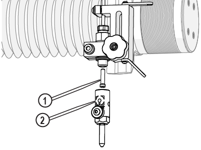

Rotate or Replace the Mixing Tube
Over time, the flow of high-pressure water and abrasive wears away the inside of the mixing tube. This wear results in a gradual, irregular widening of the internal diameter of the mixing tube, causing a less accurate stream of abrasive and water. A cross-section of these mixing tubes reveals the irregular wear of their internal diameter. A cross-section of these mixing tubes reveals the irregular wear of their internal diameter. Examples of normal [1], good [2], and bad [3] mixing tube wear are shown below
Figure 641
The mixing tube is very brittle and easily broken if dropped or struck hard. The key to a long mixing tube life is maintaining a healthy orifice or jewel. Damage to mixing tubes caused by misaligned jets or a damaged jewel is not apparent when looking through the bore of the mixing tube. The size of the kerf and cutting performance are the best indicators of mixing tube wear. The kerf is the width of the cut made by the abrasive waterjet. With a 0.030 in. (0.762 mm) mixing tube, it can range from 0.015 in. (0.38 mm) to 0.060 in. (1.52 mm), depending on the nozzle, the thickness of the material, and the amount of wear on the mixing tube.
A clogged mixing tube is most frequently caused by using contaminated garnet abrasive. Because the opening in the mixing tube is small, even a small particle of dirt can clog it. Other potential causes of clogging include contaminated or wet garnet abrasive. Metal chips from other shop operations and paper from the garnet abrasive bag are two common sources of contamination. To clear a clogged mixing tube, see 401434-EN Operation, ProtoMAX.
Inspect the mixing tube inlet and outlet ends to see if it needs to be replaced (Figure 641). See the Maintenance Schedule for the recommended frequency for this task.
CAUTION
2. Place a piece of cardboard or similar material on the cutting deck to keep the mixing tube from falling in the catcher tank.
3. Remove the nozzle splash guard [1].
Figure 642
4. Clean and inspect the splash guard for damage, replace as needed.
5. Loosen the mixing tube retainer [1] and replace or rotate the mixing tube [2] 90 degrees (one-quarter turn).
Figure 643
6. Verify the mixing tube is correctly seated in the nozzle body and tighten the mixing tube retainer.
Figure 644
7. Close the lid.
8. Perform a nozzle test, see Test the Nozzle.

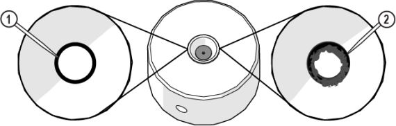

The nozzle body contains a jewel that requires regular cleaning. Replace the orifice assembly if damaged. The hole in the jewel is very small, approximately 0.008 in. (0.20 mm) in diameter. Water travels through the orifice at extremely high speeds. The water, depending on the water quality, can leave mineral deposits [2] on the jewel that is difficult to see with the naked eye. Variables such as elevated water temperature and pH, plus the presence of scaling ions (calcium, magnesium, or silicone) can cause scale to build up in and around the internal diameter of the orifice. Mineral deposits, or scale, in the internal diameter of the orifice, can form a hollow cone surrounding the small hole in the center of the jewel. Eventually, this buildup results in poor jet quality and increases mixing tube wear. The jewel can also be clogged, worn, or become misaligned.
For optimal cutting, the jewel edges [1] should be clean and sharp. The center hole is completely round with no damage in the area around the hole. Mineral deposits should not be visible or clogging the hole. See the Maintenance Schedule for the recommended frequency for this task.

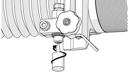

3. Remove the orifice [1] from the nozzle body.
Figure 647
4. Submerge the orifice and nozzle body into an ultrasonic cleaner filled with white vinegar.
5. Run the ultrasonic cleaner for 3–5 minutes or until clean.
6. Rinse the orifice and nozzle body with clean water.
7. Inspect the orifice to make sure the jewel [1] and vent hole [2] are clean and free of deposits.

16. Verify the mixing tube is correctly seated into the nozzle body, and the thumbscrew is tightened.
Figure 656
17. Close the lid.
18. Reset the pump, see Reset the Pump.
19. Perform a nozzle test, see Test the Nozzle.

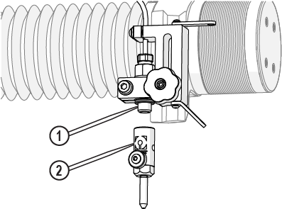

4. Remove the nozzle body [2] from the inlet body [1].
Figure 657
5. Screw the seal removal tool into the nozzle filter.
NOTICE
Do not scratch or damage the inlet body when using the seal removal tool. Doing so can cause leaking.
Figure 658
6. Pull the seal removal tool straight down to remove the nozzle filter from the inlet body.
Figure 659
7. Unscrew the removed nozzle filter from the removal tool and discard the old nozzle filter.

1. Remove the nozzle body [2] and the nozzle filter [1] from the inlet body. Discard the nozzle filter.
Figure 671
NOTICE

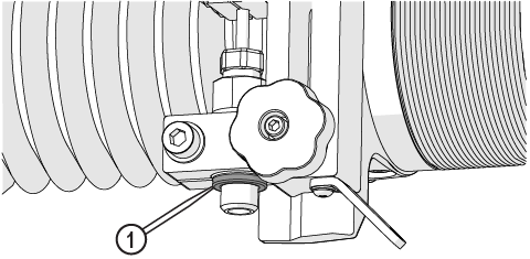

Hold the inlet body when loosening the hand knob. Do not let the inlet body fall and strike the cutting deck slats. Damage to the inlet body can occur, which can cause leaks.
2. Loosen the Z-axis [1] and lower it to the lowest position.

5. Push the button [1] on the water filter to release the air.
NOTE
Place a rag over the top of the water filter to prevent water from spraying.
Figure 673

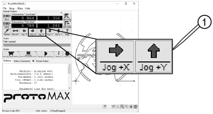

6. In MAKE, use the X, Y Jog buttons [1], or the keyboard arrow keys to position the nozzle between two slats in the center of the cutting deck.
Figure 674
7. Click Test [1].
Figure 675
8. In the Test Operations dialog box, select Flush plumbing, click Next.
Figure 676

NOTICE
Always orient the orifice assembly so that the brass [1] is visible from the top of the nozzle body. Inserting the orifice assembly in nozzle body in the incorrect orientation [2] can cause damage to the orifice assembly.
Figure 684
10. Make sure the orifice assembly [1] is seated correctly in the nozzle body chamber bore [2].
Figure 685

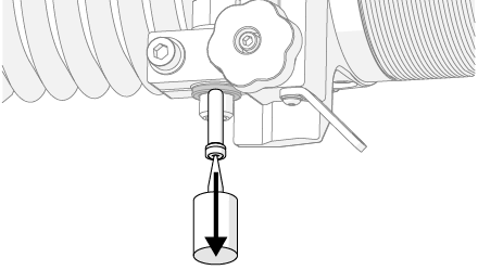

Test the Nozzle
1. Conduct a nozzle test without abrasive.
CAUTION
Figure 689
NOTE
Make sure the abrasive feed tube is not connected to the nozzle.
Figure 690
b. Position the nozzle in the center of the tank, between two slats.
Figure 691
c. Close the lid.
CAUTION
d. Click Test [1].
Figure 692
e. In Test Operations, select Test Cutting Head (Pump, Jet, and Abrasive), and click Next.
Figure 693
f. Click Start Test.
Figure 694
g. Click Close when the test is complete.
