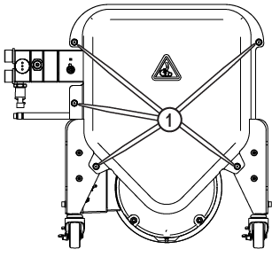

| 2. | Remove the pump cover. |
| a. | Remove the front screw [1] and set aside. |
Figure 716
| b. | Loosen the captive screws [1] and remove the front crankcase cover. |
Figure 717

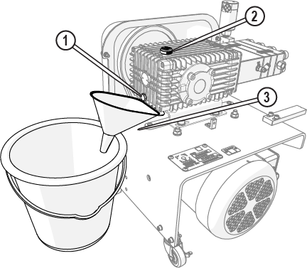

| 3. | Place a rag between the pump crankcase drain plug(Figure 718) and the frame [3] to catch oil drips. |
Crankcase oil can be hot. Be careful when removing the plug to prevent hot oil from flowing out and burning hands or fingers.
| 4. | Place a funnel and bucket below the crankcase drain plug(Figure 718). |
| 5. | Loosen or remove the oil filler port cap [2] (Figure 718). |
| 7. | Allow the oil to drain completely. |
Always dispose of used oil according to local environmental regulations.
| 8. | Replace the crankcase oil drain plug. |
| 9. | Fill with the correct amount of oil through the oil filler port. |
| 10. | Replace the oil filler port cap [2] (Figure 718). |

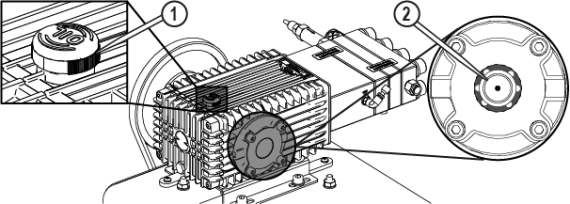

| 11. | Check the oil level, do one of the following. |
| • | Remove the dipstick [1] and make sure the oil level is at the full mark. |
| • | Make sure the oil level is at the top of the sight glass [2]. |
Figure 719
