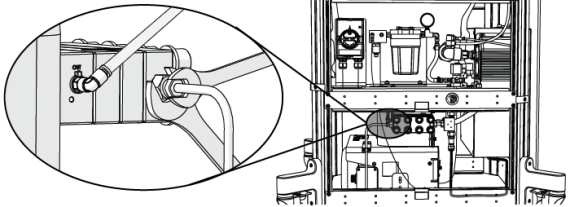

b. Loosen the gland nut [1] to release the pressure; water can leak from the inlet body weep hole.
Figure 706
c. Tighten the gland nut [1].
Figure 707

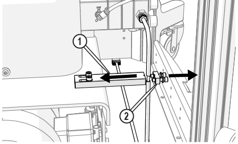

7. Remove the side panels.
8. Remove the front frame support bracket [1].
Figure 708

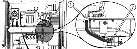

11. Loosen the high-pressure support bracket [1] and remove the support cap [2].
Figure 711

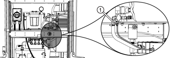

12. Disconnect the cooling line OUT [1].
NOTICE
Protect the connecting ends from external contamination or debris. Debris can enter into the high-pressure plumbing system and damage the pump or nozzle.
Figure 712

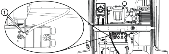

Figure 714
15. Disconnect the transducer cable [1].
NOTICE
Figure 715

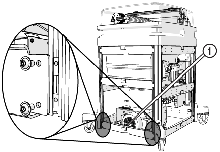

16. Unlock the pump wheels and move the pump out from the machine.
