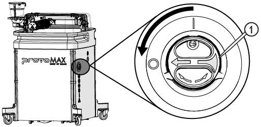

3. Turn OFF the machine and close MAKE.

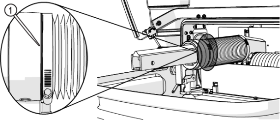

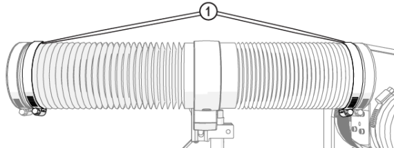

4. Rinse and wipe away all debris from the bellows [1].
Figure 814

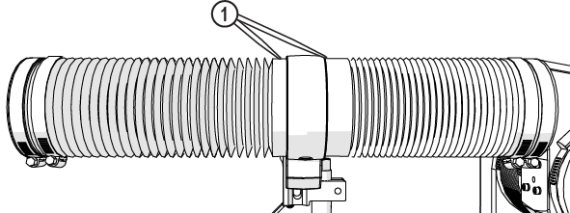

5. Place a piece of cardboard on the cutting deck to keep components or tools from falling in the catcher tank.

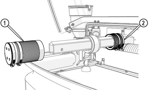

6. Loosen the center clamps [1].
NOTICE
Do not move the bellows away from the Y-axis carriage. The area around the Y-carriage must be clean of debris to prevent erosion damage to the internal components.
Figure 815

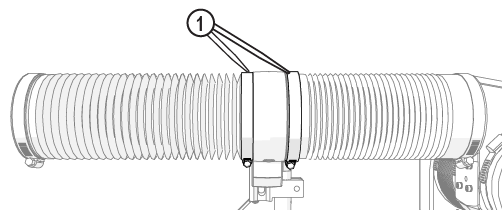

7. Push up on the bottom of the clamps [1] to loosen, then slide the clamps toward the ends.
NOTICE
Clamps can stick to the bellows. To prevent damage to the bellows, use care when removing the clamps.
Figure 816

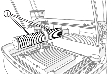

8. Wipe the bellows ends [1] and Y-axis carriage with a clean rag; remove all debris.
Figure 817

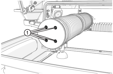

9. Remove the end capscrews [1] and set aside.
Figure 818
NOTICE
Use care when removing the bellows from the Y-axis carriage. Ripping or tearing of the bellows ends can allow debris in the Y-axis and can cause damage to the internal components.
10. Remove the end cap and bellows.

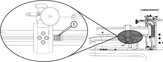

11. Slide the rear bellows [2] from the Y-axis carriage(Figure 819).
12. Clean all debris from around the lead screw nut [1] with a dry, soft cloth.
Figure 820

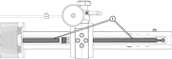

13. Apply a light coat of lubricant, approximately a 1/8 in. bead, along the length of the lead screw [1].
Figure 821

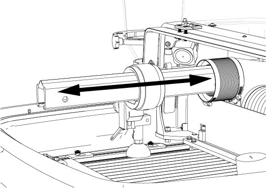

14. Turn ON the machine and open MAKE.
15. Using MAKE, move the Y-axis the full length of travel three times.
Figure 822

17. Close MAKE and turn OFF the machine.

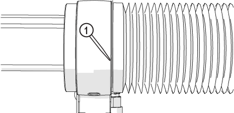

18. Reattach the rear bellows to the Y-axis carriage, pulling the bellows lip over the Y-axis carriage edge.
NOTICE
Ensure there is an even gap [1] between the Y-axis carriage housing and the bellows lip to keep debris from entering into the bellows and causing damage to the interior components.
Figure 823

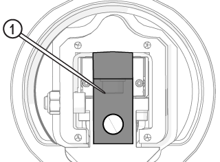

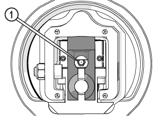

22. Identify if the lead screw support bracket configuration, then complete the applicable procedure.
• If there is access [1] to the grease port, go to Lubricate the Y-Axis Linear Rail Bearing Carriage with Grease Port Access.
Figure 826
• If there is no access [1] to the grease port, go to Lubricate the Y-Axis Linear Rail Bearing Carriage without Grease Port Access.
Figure 827
