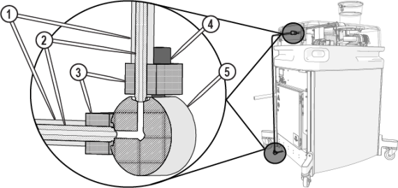

High-pressure fitting connections are located on the ends of the high-pressure nipple at the back of the machine. The high-pressure fittings consist of the following components.
Figure 808
[1] Conduit [2] High-pressure nipple [3] Bar clamp [4] Bar clamp screw (x 2 per bar clamp) [5] 90-degree fitting

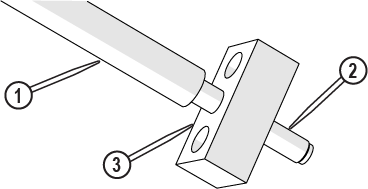

a. Place the high-pressure line [2] in the conduit [1] (Figure 810).
b. Place the bar clamp [3] over the high-pressure line.
Figure 810

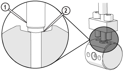

5. Seat the high-pressure nipple [1] into the high-pressure fitting [2] and secure with the bar clamp and screws.

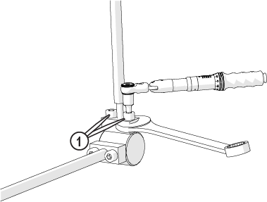

6. Tighten the bar clamp screws [1] evenly.
NOTICE
Always tighten the bar clamp screws evenly (1/4–1/2 turn at a time) to the correct torque to make sure the high-pressure nipple seats correctly. Do not overtighten the bar clamp screws. Over tightening the screws can damage the high-pressure nipple tapered edge or the concave high-pressure fitting and damage the high-pressure seal. Damaged high-pressure seals can cause the connection to leak.
Figure 812

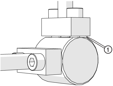

NOTE
There is a small, even space [1] between the bar clamp and the high-pressure fitting when correctly torqued.
