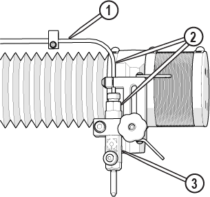

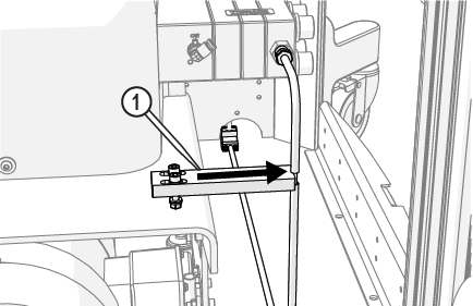

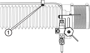

5. Loosen or remove the Z-axis tubing clamp [1].
Figure 786

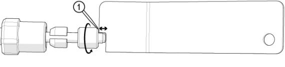

11. Use the stand-off tool [1] to set the collar depth.
NOTICE
High-pressure nipples have left-hand threads, therefore when connecting components, turn clockwise to loosen and counterclockwise tighten. Cross threading high-pressure connections can cause leaks and water damage from the leak(s).
Figure 790
12. Support the high-pressure tube [1], so the nipple is perpendicular [2] to the inlet body [3], then attach the gland nut to the inlet body and hand-tighten (Figure 789)

14. Attach the z-axis tubing clamp [1].
Figure 793

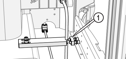

15. Install and tighten the nipple tubing clamp [1].
Figure 794

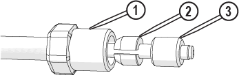

7. Place the gland nut [1] on the nipple.
Figure 798
8. Place the slotted collet [2] on the nipple with the tapered end facing the gland nut [1] and thread the collar [3] on the nipple (Figure 95).
9. Use the stand-off tool [1] to verify the collar depth.
NOTICE
High-pressure nipples have left-hand threads, therefore when connecting components, turn clockwise to loosen and counterclockwise to tighten. Cross threading high-pressure connections cause leaks and water damage from the leak(s).
Figure 799

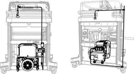

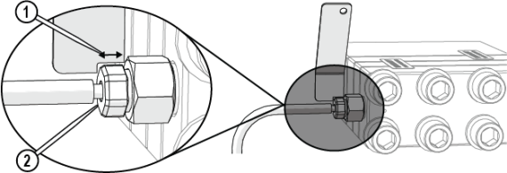

10. Position the pump so that the high-pressure plumbing is aligned vertically and horizontally, and the rear of the pump is 1–2 in. (3–5 cm) from the control cabinet.
Figure 800

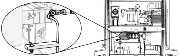

11. Attach the assembled u-shape nipple [1] to the pump high-pressure outlet OUT connection [2] and hand-tighten.
Figure 801

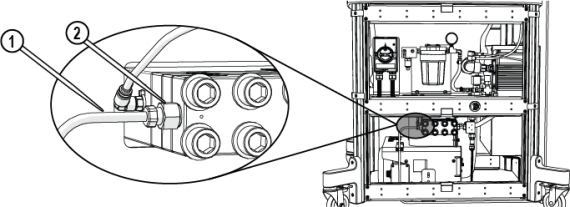

12. Verify the gland nut [2] is set approximately to the depth of the nozzle stand-off tool [1].
Figure 802

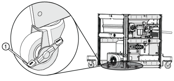

14. Lock the pump wheels [1].
