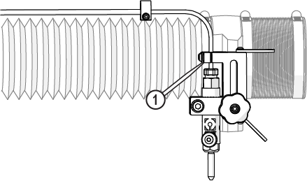

| b. | Loosen the Z-axis tubing clamp [1]. |
Figure 781
| c. | Loosen the gland nut [1] to release the pressure; water can leak from the inlet body weep hole. |
Figure 782
| d. | Tighten the gland nut [1], if needed. |
