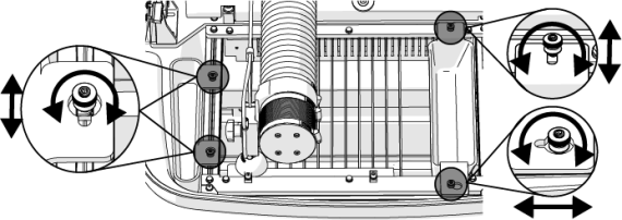

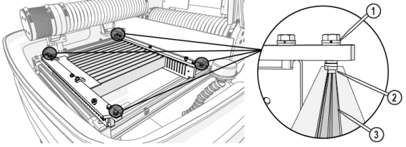

| 6. | Remove the slat or polymer cutting deck for easy access. |
| a. | Loosen the cutting deck bolts [1] and align the t-nuts [2] with the frame slot [3]. |
Figure 869

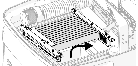

| b. | Carefully lift the cutting deck out of the catcher tank. |
Figure 870

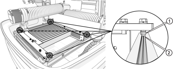

| 9. | Reinstall the cutting deck. |
Figure 871
