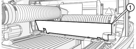

1. Remove the bellows protector splash shield [1].

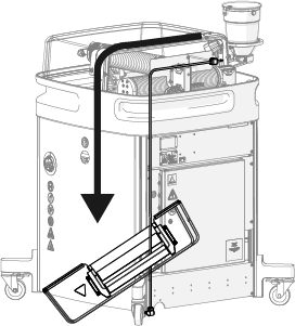

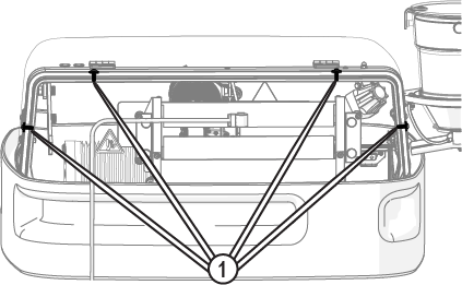

4. Remove the screws and washers [1] securing the rear lid and set aside.
Figure 844
5. Lift the lid, then slide it down the high-pressure plumbing to the floor.
NOTE
To prevent scratches to the lid, place it on a soft surface.

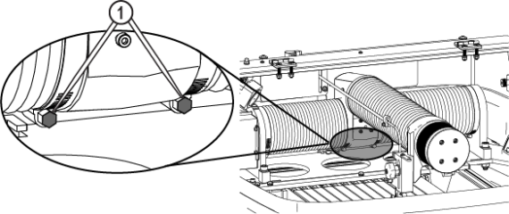

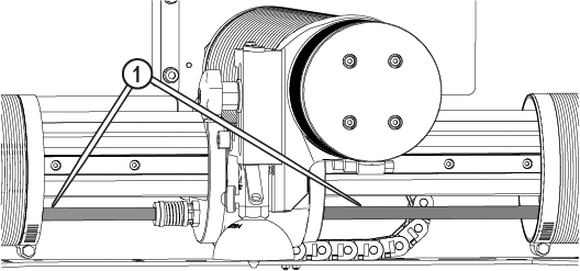

8. Loosen the center clamps [1].
Figure 847
Figure 848
9. Push up on the bottom of the clamps to loosen, then slide the clamps toward the ends.

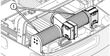

10. Wipe the bellows ends [1] and X-axis carriage with a clean rag; remove all debris.

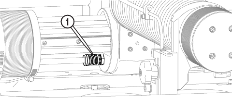

11. Move the bellows to the ends of the axis and clean all debris from around the lead screw nut [1] with a dry, soft cloth.
Figure 849
12. Apply a light coat of lubricant, approximately 1/8 in. bead, along the length of the lead screw [1], then spread the lubricant along the lead screw surface.

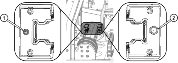

14. Identify if the linear rail bearing carriage has a set screw [1] or grease fitting [2], then complete the appropriate step.
Figure 852
15. Lubricate linear rail bearing carriages with a grease fitting:
a. Attach the grease gun nipple to the grease fitting.
b. Pump the grease into the linear rail bearing carriage until it comes out the edges [1].
Figure 853
16. Lubricate linear rail bearing carriages without a grease fitting:
a. Remove the set screw.
b. Insert the grease gun needle into the set screw port.
c. Pump the grease into the linear rail bearing carriage until it comes out the edges [1] (Figure 853).

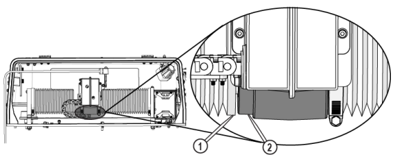

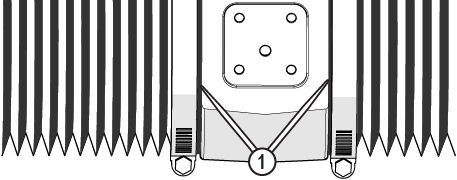

17. Reattach the bellows to the X-axis carriage, pulling the bellows lip [1] over the carriage edge [2].
NOTE
Rotating the bellows helps to eliminate rub marks or holes on the interior of the bellows, prolongs the bellows life. If needed, loosen the clamp at both ends of the bellows, rotate the bellows approximately 90 degrees then secure with the clamps.
Figure 854
NOTICE
Make sure there is an even gap [1] between the X-axis carriage housing and the bellows lip to keep debris from entering into the bellows and causing damage to the interior components.
Figure 855

19. Replace the bellows protector splash shield [1].

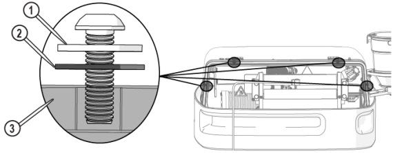

20. Replace the rear lid and secure with the screws and washers (x 4) (Figure 857).
NOTICE
To prevent damage to the lid [3], place the rubber washer [2] between the lid and the metal washer [1]. Do not over tighten the screw.

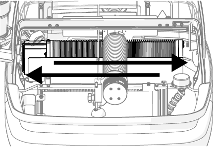

21. Move the X-axis side to side three full strokes to distribute the lubricant along the lead screw.
