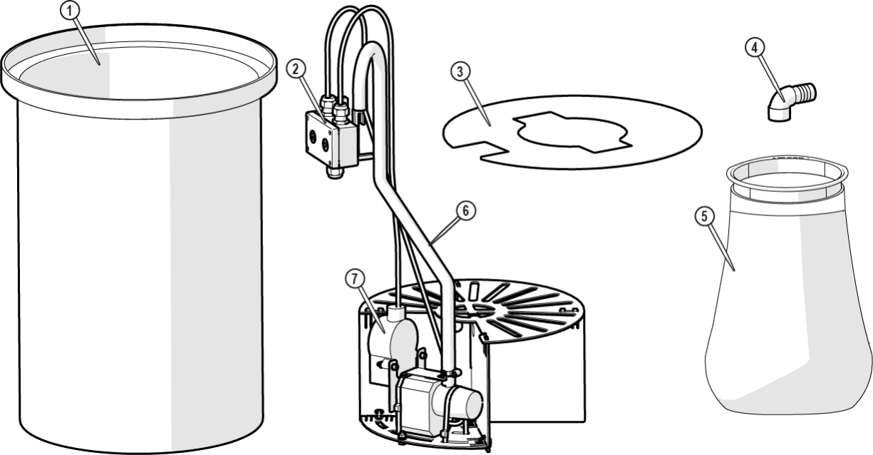

1. Remove the drain water filter tank and components from the box.
Figure 1
[1] Tank [2] Pump control box [3] Cover [4] 90-degree elbow
[5] Filter bag (2 units) [6] Hose (to drain) [7] Pump assembly
Note
The pump assembly comes already installed inside the tank. All other components are shipped inside the tank.

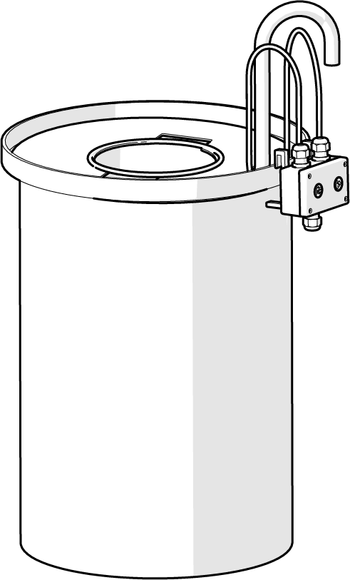

2. Remove the tank cover [3] and take the pump control box and cables [1] and hose [2] out of the tank [4].
Figure 2
3. Take the 90-degree elbow and filter bags out of the tank and set aside.
4. Route the cables and hose through the tank cover slot [1], and then replace the tank cover [2].

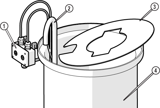

1. Attach the pump control box [1] to the side of the tank away from the drain hose [2].
Figure 4

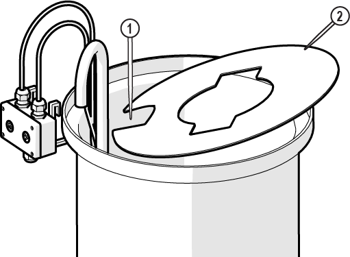

2. Insert the filter bag [1] through the tank cover hole until the filter lip [2] sits properly on top of the tank cover.
Figure 5

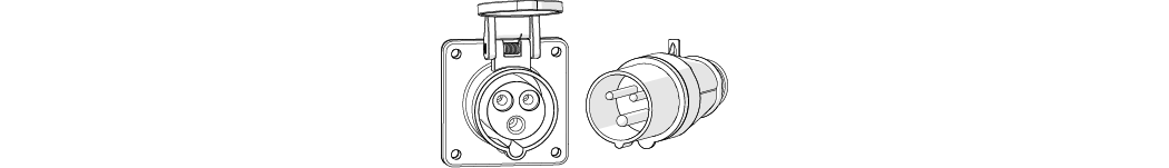

Install a Power Plug
The Drain Water Filter Tank is shipped without a power plug.
OMAX recommends connecting an industrial grade pin and sleeve plug that meets the following criteria:
  • 16 A, 250 VAC, 2-pole, 3-wire, IP44 or better
  • Has a first-make last-break protective bonding contact (earthing contact)
  • Suitably rated in accordance with EN 60309-1, -2 or IEC 60309-1, -2
  • Suitably rated for its intended use and complies with local, regional, or national electrical codes
An example of a suitable plug and a matching outlet is shown below.
Figure 10
Warning
Electrical wiring connections should be performed by qualified personnel only and in accordance with local, regional, or national electrical codes.
