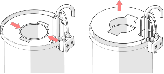

| 1. | Make sure that the ProtoMAX is turned off. |
| 2. | Unplug the drain water filter tank from the power source. |
| 3. | Set aside the catcher tank drain hose. |
| 4. | Compress the filter bag lip, then remove the tank cover. |
Figure 11
| 5. | Lift the filter bag from the tank and place it in a watertight container. |
Figure 12
