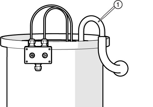

| 1. | Attach the pump control box [1] to the side of the tank away from the drain hose [2]. |
Figure 4

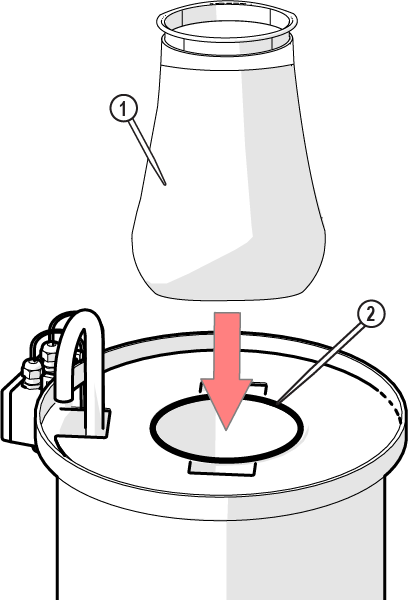

| 2. | Insert the filter bag [1] through the tank cover hole until the filter lip [2] sits properly on top of the tank cover. |
Figure 5
| 3. | Expand the filter bag sides. |

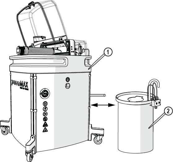

| 4. | Place the drain water filter tank [2] approximately 12 in. (30 cm) from the right rear corner of the machine [1]. |
Figure 6

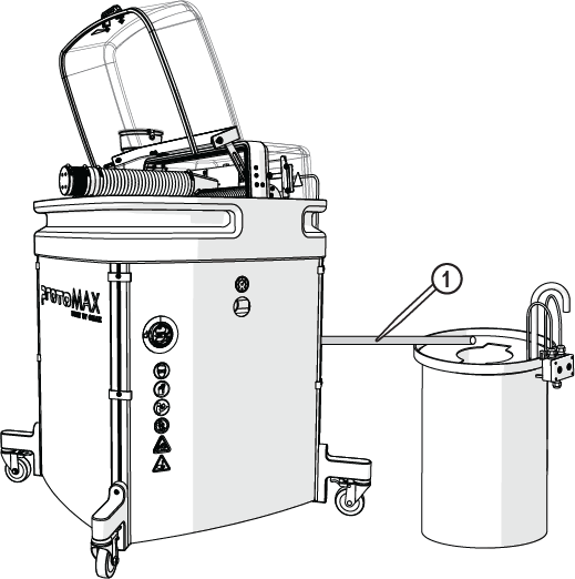

| 5. | Measure and cut the catcher tank drain water hose [1] so it reaches the middle of the tank cover, if needed. |
Figure 7

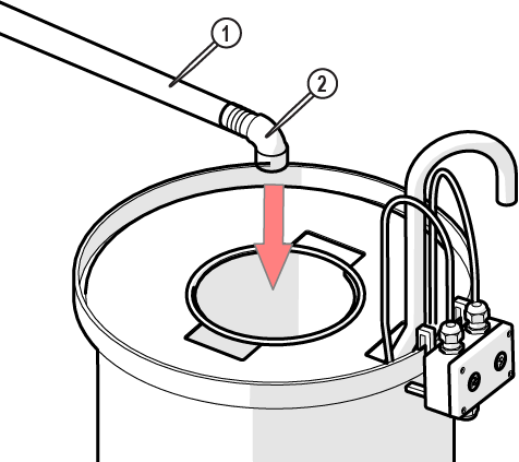

| 6. | Insert the barbed end of the 90-degree elbow [2] to the catcher tank drain hose [1] , then position the elbow at the center of the tank cover. Secure the hose with the filter bag strap, if needed. |
Figure 8
To avoid clogging the drain hose or overflowing the tank, make sure the 90-degree elbow is positioned in the center of the filter bag and there are no bends, kinks, or sags along the catcher tank drain hose.
| 7. | Connect the drain water filter tank hose [1] to the drainage system. |
Figure 9
