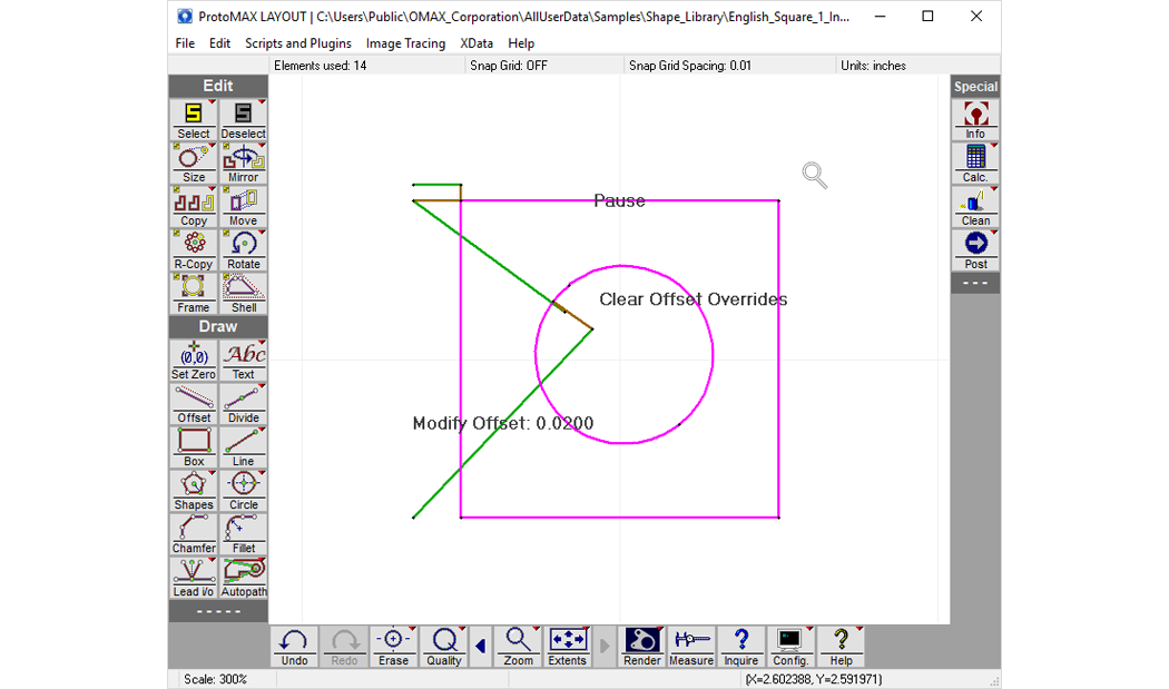

XData is eXtra Data that can be assigned to entities in LAYOUT to command specific tool path actions.
XData assignments using "Draw XData as text" Redraw Style

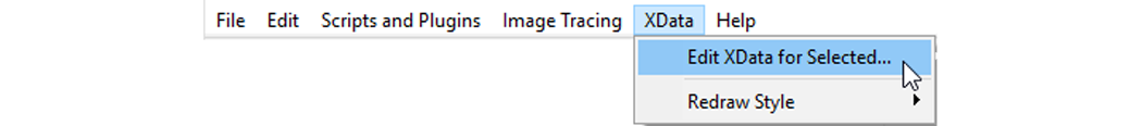

XData functions are accessed from the ProtoMAX main menu:
Examples of how XData can be used:
- Add pause points to a path
- Add a comment to an entity
- Specify a different cut speed for an entity/entities
