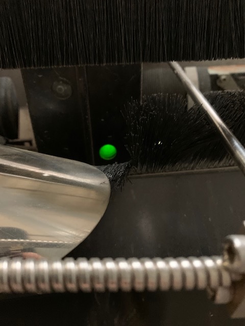

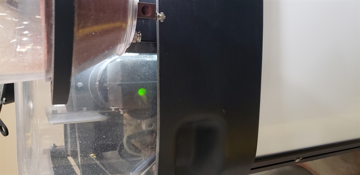

The X- or Y-axis cutting stage motor has faulted. Inspect cutting table for obstacle.
Error Code: 30.7
Corrective Actions:
  • Ensure high-pressure plumbing movement is not restricted.
  • Remove obstacles in the cutting path.
  • The nozzle may have collided with the material, slugs, or material holding fixtures.
    1. Clear the nozzle of obstacles.
    2. To clear the fault, reset the machine home (re-home the machine).
  • Locate LED readout on both X- and Y-axis motors
    Click on image to see X-axis motor readout
    Click on image to see Y-axis motor readout
    1. If the red LED displays, contact Technical Support.
    2. If the yellow LED displays, continue to the next section.
  • Close MAKE and turn OFF the ProtoMAX machine.
    1. Turn ON the ProtoMAX main power and wait 30 seconds.
    2. Open MAKE.
      Notice
      Do not select Homing Routine.
    3. Use the Jog keys to move X and Y for approximately 2 in. (50 mm) in each direction.
    4. Right-click on the bottom Go Home button, and select Reset Machine Home (Re-Home Machine).
  • If event persists, record LED readout and blink sequence for both X and Y axes, and then contact Technical Support.
