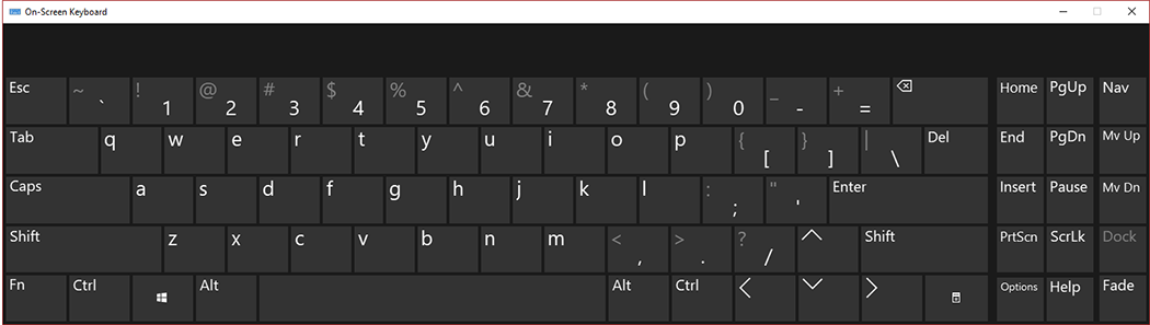

The Windows on-screen keyboard
The on-screen keyboard allows you to type using your touch screen without the need to attach a physical keyboard. To display the on-screen keyboard, touch Keybrd.

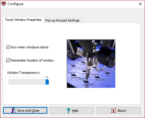

You can configure the Touch utility by using the Configure dialog. To open the Configure dialog, touch Config.It has two tabs: Touch Window Properties and Pop-up Keypad Settings.
Touch Window Properties tab
| Element | Description |
| Run when Windows Starts | Select to ensure that the Touch utility automatically starts up when Windows is started. |
| Remember location of window | Select this option to allow the pop-up window to open in the same location as the previous session. |
| Window Transparency | Adjust this slider to controls the transparency of the Touch utility’s pop-up window. Moving the slider to the far left makes the pop-up nearly invisible. The default slider position is at the far right where the pop-up becomes most visible. |

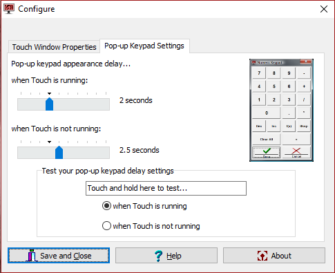

Pop-up Keypad Settings tab
| Pop-up keypad appearance delay... when Touch is running | While Touch is running, this slider controls the time delay before the pop-up keypad appears when you hold your finger on a text box in many Intelli-MAX Software applications and utilities. The default setting is two seconds. |
| Pop-up keypad appearance delay... when Touch is not running | While Touch is closed, this slider controls the time delay before the pop-up keypad appears when you hold your finger on a text box in many Intelli-MAX Software applications and utilities. The default setting is two seconds. Once changes to the delay settings for the pop-up keypad are made, you can test them by touching and holding the text box ("Touch and hold here to test") and selecting the appropriate option. |
Changing either the delay setting or choosing either option causes the text in the testing text box to change back to its original message of "Touch and hold here to test…".
