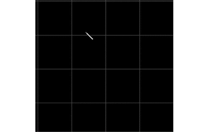

There are two approaches to using the Sketch command:
  • Click discrete points to add the next segment
    As you add points, LAYOUT smooths out previous points. To stop drawing, press Esc.
  • Hold down the left mouse button as you draw
    Holding down the mouse button produces more points as you move the cursor, accurately tracking your motions. To stop drawing, press Esc.

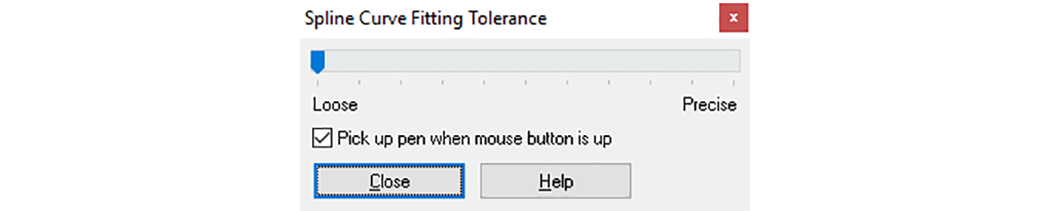

After activating the Sketch command, a control bar appears that lets you set the level of control you want.
The Sketch tolerance dialog
The "Loose" setting will use fewer arcs and lines as it smooths, while the "Precise" setting will attempt to exactly match where the cursor moves. These settings have more effect when you draw holding down the left mouse button.
The Pick up pen when mouse button is up lets you configure the command to your preference. When this is checked, you draw by holding down the left mouse button and moving the mouse. Releasing the mouse button lets you move to a new location to begin a new feature.
When it is not checked, you can click to specify points, or hold down the left mouse button as you move the mouse. Everything you draw is connected to the previous point.
