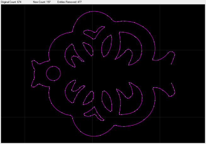

The following illustration shows a portion of the sample DRAGON.DXF that has been smoothed. This drawing was originally created in CorelDRAW and as a result, has many short line segments. Note how these line segments are replaced by arc segments.
Before smoothing, with 674 entities
After smoothing, with 197 entities

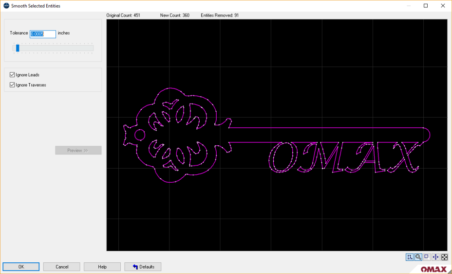

3) The Smooth dialog appears:
4) Choose your smooth settings and options then click OK to proceed with smoothing.
The tool path is updated to the new version. If there is a problem with the smoothed version, use Undo to restore the original
Tolerance
How closely the arcs should follow the original tool path. A "High" tolerance will try to follow the original tool path very closely, while a "Low" tolerance will not. The lower the tolerance, the fewer entities in the final drawing (more smoothing will occur). The tolerance should be in the range of 0.0 to 0.5 inches (0 to 1.3 cm).
When using a tolerance value that is outside of the allowed range of 0.0 to 0.5 inches (0 to 1.3 cm), use the Size command to enlarge the drawing, use a different tolerance value, and then size the drawing back.
Ignore Leads
When this is checked, lead-ins and lead-outs are not smoothed. If the preview shows unusual geometry, this may need to be unchecked.
Ignore Traverses
When this is checked, traverses are not smoothed. If the preview shows unusual geometry, this may need to be unchecked.
Preview
Click to view what the smoothed part will look like. The top of the window shows how many entities will be left after smoothing.
